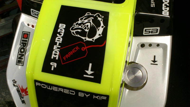

New Short Stack Uni Quick Release Air Filter, Fit perfectly with bodyShell Cab
Tlr 5B ameliorations by Kif Dsc_0022

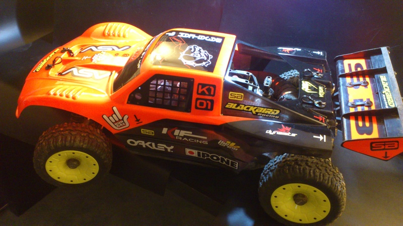

Mod day : TLR 5B with  Trophy Truck BodyShell on SB Mode (Short Buggy) by Kif Racing
Tlr 5B ameliorations by Kif Dsc_0023
Tlr 5B ameliorations by Kif Dsc_0027
Tlr 5B ameliorations by Kif Dsc_0026
Tlr 5B ameliorations by Kif Dsc_0028
Tlr 5B ameliorations by Kif Dsc_0024
Tlr 5B ameliorations by Kif Dsc_0025
Tlr 5B ameliorations by Kif Dsc_0029
Tlr 5B ameliorations by Kif Dsc_0030
